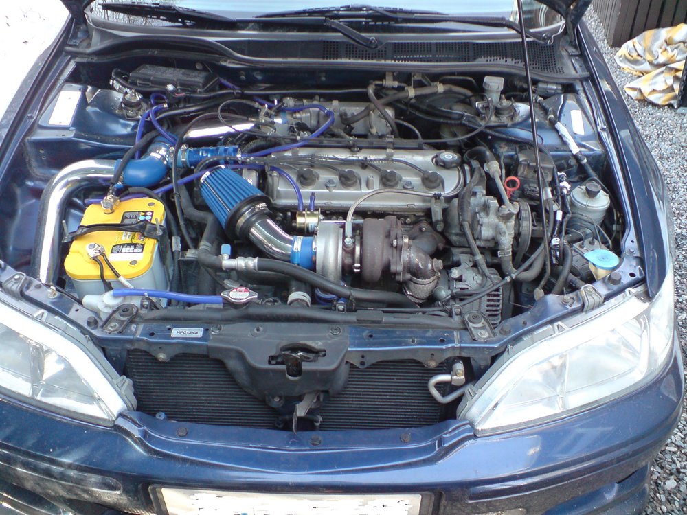

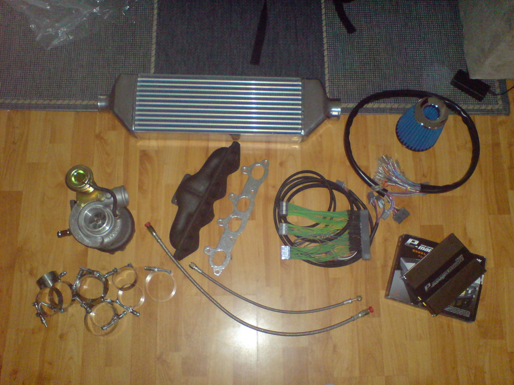

Hello. It is now a time for some update on my CG8 Turbo project. I got everything I need exept new 370cc fuelinjectors, intercooler pipes and a downpipe. My goal is to get the car finish before may. Here are some of the part list. Turbo Header Mitsubishi TD04 turbo Greddy E-manage Ultimate Greedy Profec b spec2 Greedy Full auto turbo timer Obd2b E-manage ultimate harnesskit Air filter (unknown types) Intercooler Carbon gaugepod Boost gauge, oil temp, oil pressure etc etc I have mounted the E-manage ultimate, that is a piggyback. It overruns the stock ecu when you change the signal. The car runs normally, and I can just plug my computer to it and log, change and tune :) The turbo will be topmounted, sinde the the header is build like that, so I am really excited how it will look like whent its mounted :) I will try to keep this post updated.. as we start with the building.. :) Here are some pictures.

Hello. I have now started on my CG8 Turbo project (f18b2). Custom ALL the WAY :P I dont think there is many Accord cg8 with turbo around in europe. Not that I have heard about. I Will be the first in Norway with it :D So i will keep you guys updated, with pictures and videos when its ready for the road. :D
